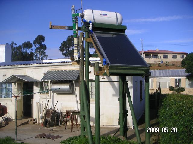

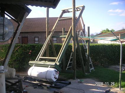

Postby turning green on Sun May 17, 2009 4:40 pm

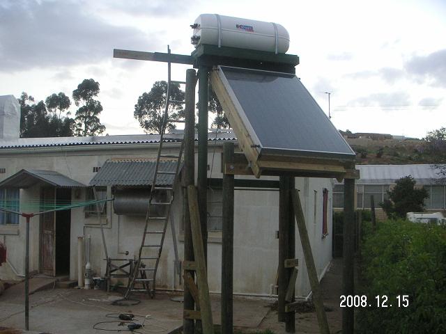

My solar geyser saves me between R100 and R150 per month.
I bought an Xtream geyser and glass faced, copper tubed solar panel from SolarMax in Cape Town and it all came to R7500. My equipment is commercial state-of-the-art and the only home-built part of the deal was the installation which I did myself.
Using Roman catapult technology I erected the whole thing on treated poles.It was a study in articulation and I "catapulted" the geyser to 4.3 meters high and the panel was jacked up on rails and then swung into place immediately below the geyser. The panel is mounted at 40 degrees slope (for South Africa the recommended slope is between 38 and 45 degrees and it faces absolute true north. I insulated all piping, input and output. It has no interference from trees, buildings etc and the only interference between the panel and the sun are clouds.
I found out quickly that if the panel didn't receive absolute clear sunlight for at least two hours a day (summer or winter and is unaffected by wind or outside temperature) then the supply of hot water is not adequate and the electrical element must be switched on - this has happened three times since December 2008. It means that here in the Southern Cape it works admirably.
A couple of considerations. Most people mount their solar geysers on the roof. Not everyone has a true north facing aspect and not everyone can ensure the required slope. Not everyone can erect the geyser immediately above the panel. Not everyone has adequate insulation. Incidentally I chose the geyser that does not have a heat exchanger so the water that passes through the panel is the water that gets stored in geyser and gets used domestically - I'm exposed to freezing but I wanted maximum efficiency.
I wanted the system to work and it does. It may even pay for itself - it's already saving me money. I regard it as one of my most successful ventures.

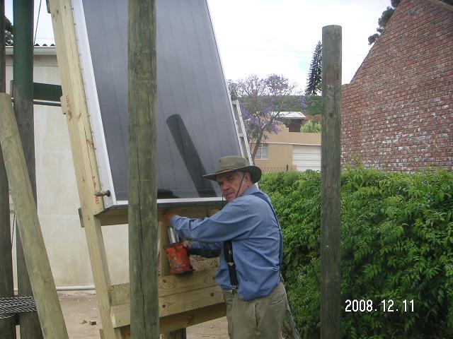

Postby turning green on Sun May 17, 2009 4:54 pm
This picture is abit outdated as it does not show the piping and insulation but the idea is there.

Postby windgat on Sun May 17, 2009 6:39 pm
Wow. It would be great to see a diagram to understand what 'Roman Catapult technology' is!
Re: The price of learning by experience

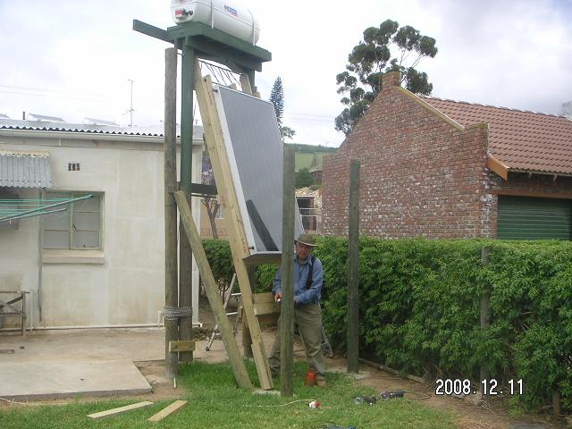

Postby turning green on Mon May 18, 2009 5:28 am
I assembled the geyser on the ground and then swung it up to it's final position.
Postby turning green on Mon May 18, 2009 5:46 am
Jacking up the panel on the "rails" that were hinged to swing the panel into position.
Postby turning green on Mon May 18, 2009 5:48 am
Panel ready to swing into final position.

Postby Greystoke on Mon May 18, 2009 7:03 am
Now that's a bit better, and it looks impressive. :D .
Let's take an average saving of R125/month, that means a pay-back time of 60 months (ie: 5 years).
Are you getting a subsidy from ESKOM? (or Google: "Eskom subsidy")

Postby turning green on Tue May 19, 2009 8:23 pm
The Solar Geyser 19th May 2009 - my camera is one day ahead.

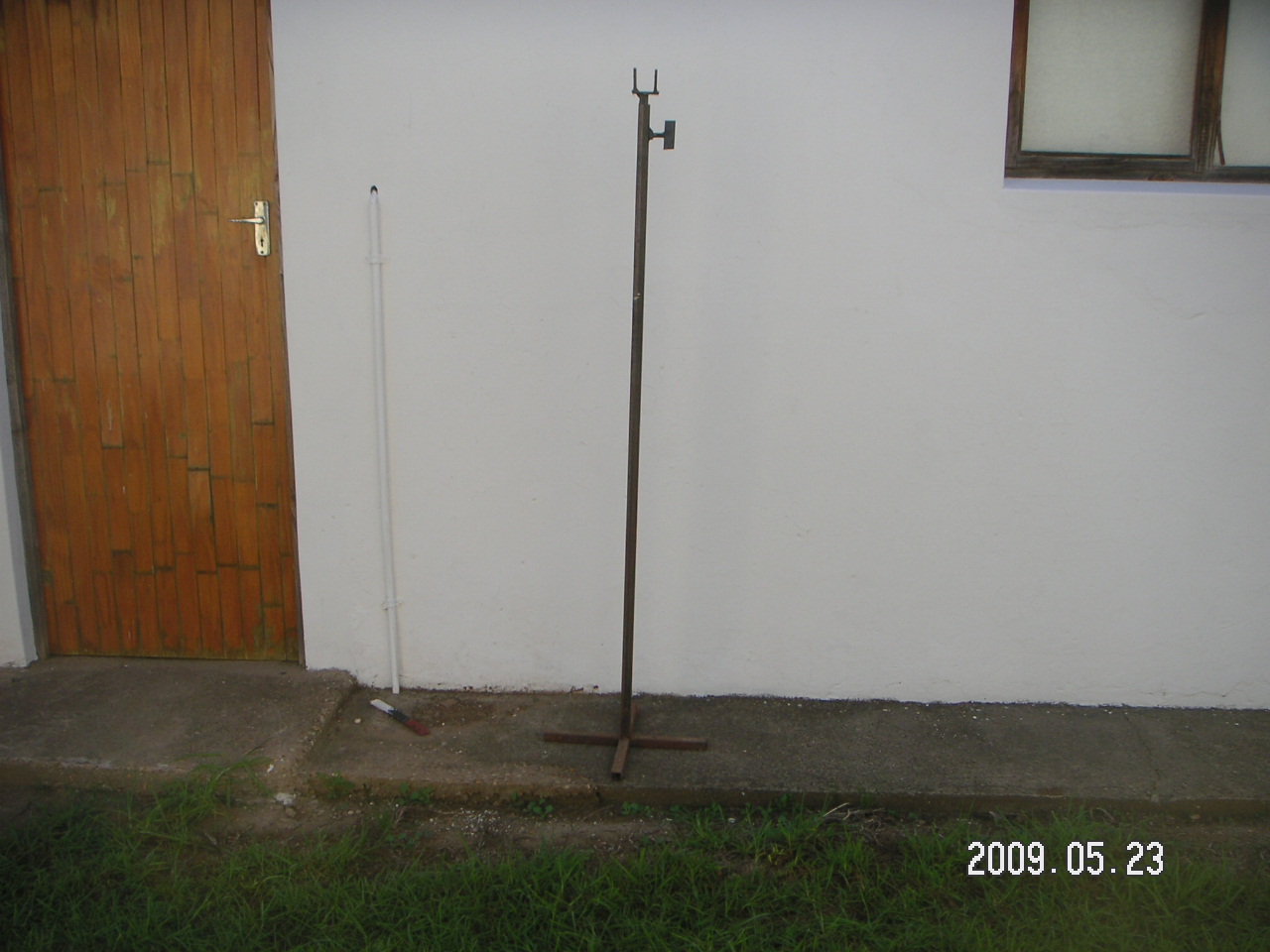

The first is the Appy. I had some of the worst ceiling damage in Kempton Park due to HEAVY hail, not big hail just too much of it, and I was struggling trying to replace the ceilings by myself. Well he came there and said "You need an Appy !" to which I replied "I don't want to employ or hire people." and in turn he said "Obviously you don't know what an Appy is.".
Is it a person or a thing ?? It's the latter. He loaned me his with the condition that I promise to build my own. I promised and I did. By the way I replaced all the ceilings in my house on my own using that Appy and I've never been without my Appy since.
What is an Appy ?? I'll post a photo of my Appy after this post. It's dead simple - A 1.6 meter of 25mm sq tube with a simple foot and a 1.7 meter of 20mm sq tube that fits inside the 25mm tube. In the 25mm tube is a hole with a nut welded round it and a butterfly bolt to fit the nut. In other words they can be locked in position. A piece of 25mm flat is welded across the top of the 20mm tube with two little uprights 40mm apart forming a U. That's it !!! I've built wooden frames with the universal 114 x 38mm raftering wood and slotted one edge into the U. The frame is lifted into position for whatever job and locked - the Appy stands tirelessly there and holds up whatever - obediently and diligently. I've never looked back. I don't think it took me longer than two hours to make and it's lasted me much more than twenty years !!!

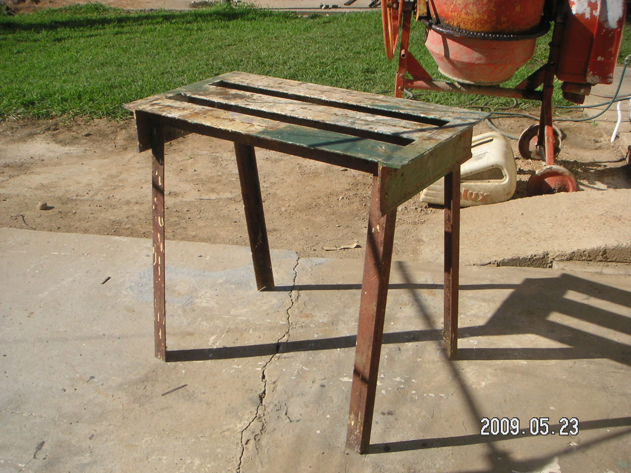

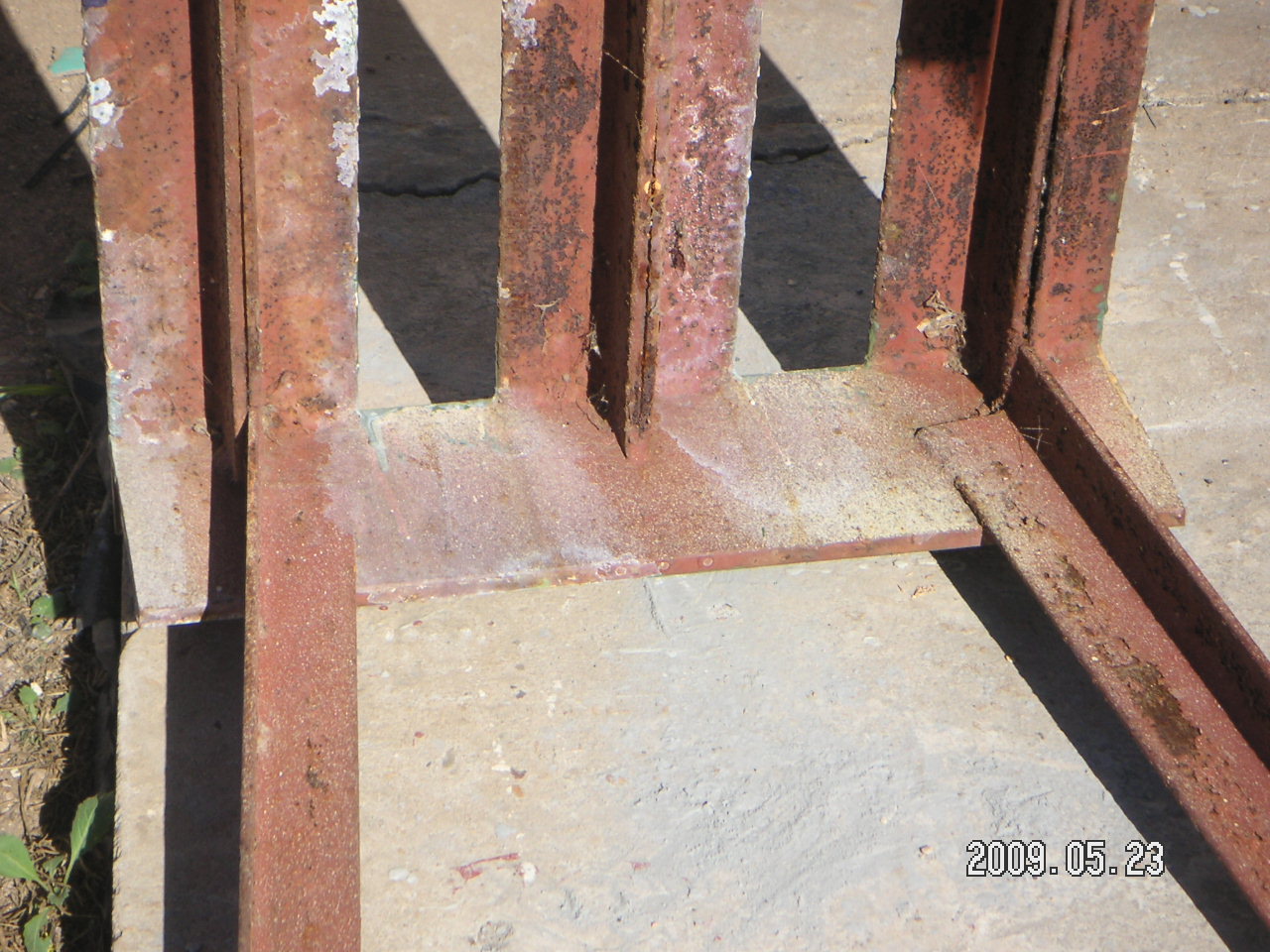

The second is a measuring table. If you can't grip a job then you cannot work or weld it. He had a design there that was built with 60mm angle iron. 10 pieces of 60mm angle 80 cm long and 4 pieces of 60mm angle 50 cm long are cut accurately (I had mine done by the steel merchant that had an accurate cutoff machine. From the photo you can see that 3 sets of two 80 cm pieces are welded back to back and then placed between two 50mm pieces with approx two 7 cmm gaps. ie the table top is 92 cm x 50 cm. One side of each of the two 50 cm pieces is cut off (quite difficult or just buy two 50 cm 60 mm flat bars) and extend the two ends downward. Weld the four legs on splayed at an angle of 7.5 degrees from vertical - The height of the table 85 cm. The feet are trimmed to be level on the floor. The whole thing took me about a day to make and I made two identical ones. Sadly I gave one away when I moved to the Cape and I've had many times to regret that since - No doubt I'll build another one day. I have about twenty clamps of different sizes and there's very few jobs I've not been able to work.
I'll post the picture later - my camera's battery went flat after the Appy.

Postby turning green on Fri May 22, 2009 8:20 am
My Appy. Still patient and obedient after twenty years !!

Postby turning green on Fri May 22, 2009 11:33 am
The measuring table stands outside waiting for me to use it.
turning green
Hyper active member
Posts: 65
Joined: Mon Feb 09, 2009 8:01 pm

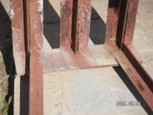

Postby turning green on Fri May 22, 2009 11:43 am
I turned the table onto it's one end to show how it all fits together. Notice all the edges that can be clamped on - all round and the four inner edges. I'd be lost without it and I sorely miss it's identical twin.

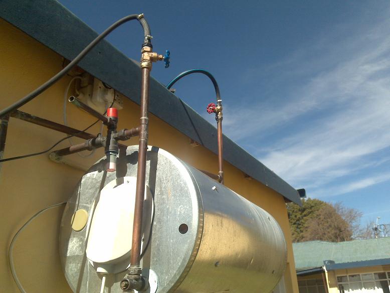

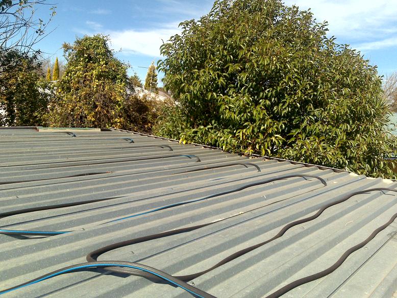

For the ones who are interested I’m going to share my experiences with you. My solar geyser is unconventional but does the job.
The roof is used to heat the water which is transported by rubber hose. The roof temperature goes up to about 60C in the summer and about 50C in winter.
The water is being pumped into a normal geyser

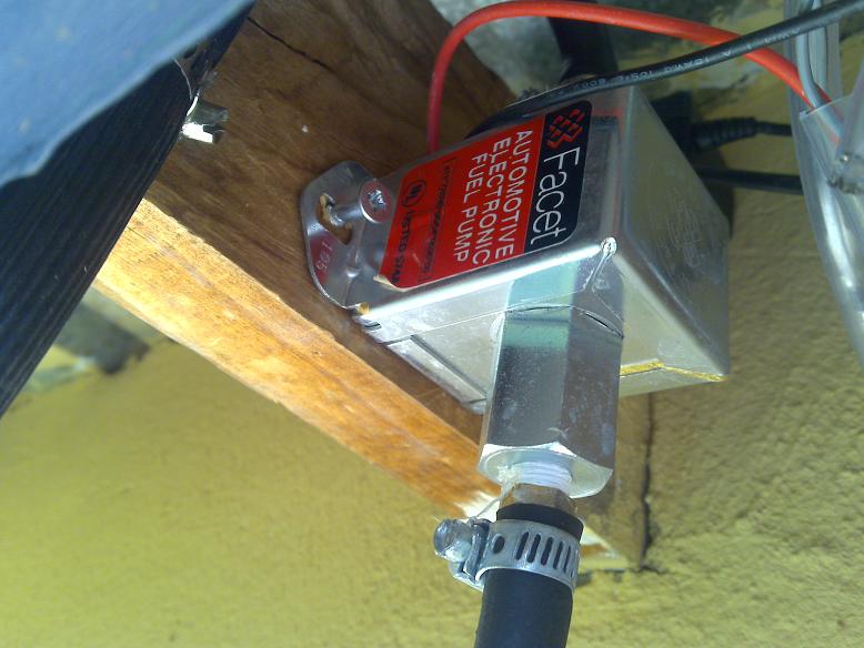

To pump the water around a automotive fuel pump is being used

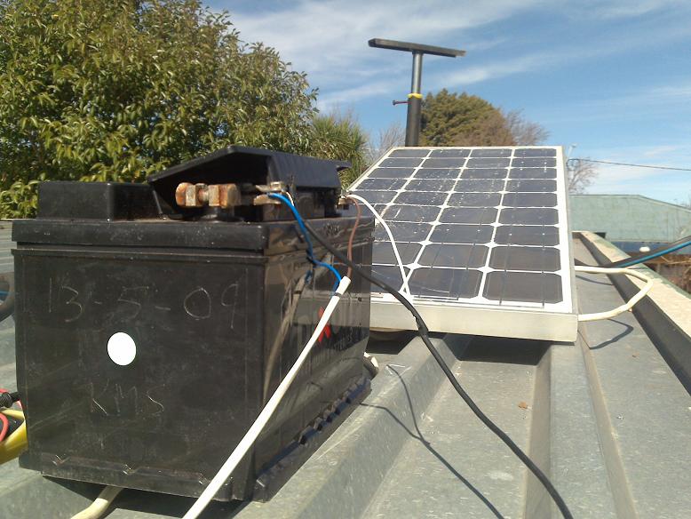

To drive the fuel pump a standard battery is used which is charged by an old solar panel. But its probably a lot easier and more cost effective to use a small 12V charger.

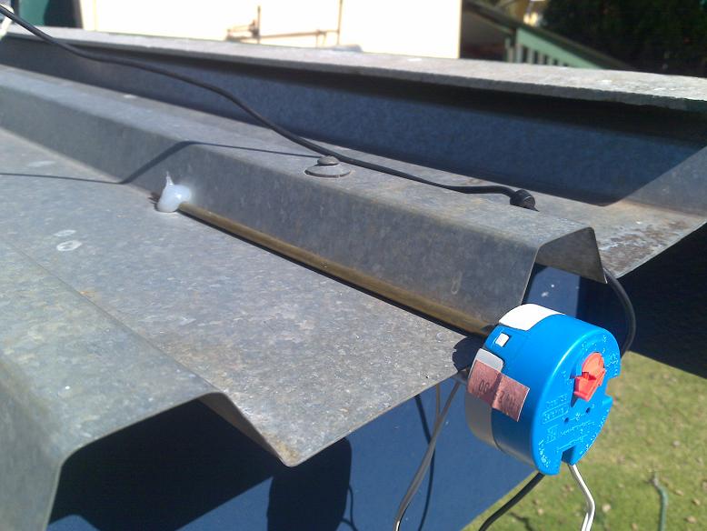

To switch the pump on and off a standard geyser thermostat is used in combination with a relay. When the roof is hot enough the pump switches itself on in the morning. And off in the evening.
The whole system does not yet provide all the hot water needed to shower. So currently every morning a timer is still needed to switch on eskom power for 1.5 hour to bring the water up to a decent shower temperature. So there is some room for improvement.
So far my contribution to a better world. Any comment is welcome.

Postby windgat on Thu Jun 04, 2009 2:44 pm
Looks great! :clap:
Do you know the geyser element wattage? Could then esitmate the power used/saved.
An hour an a half seems like a long time. are you sure that long is needed? Would be great if you could monitor and record the actual water temperature!
