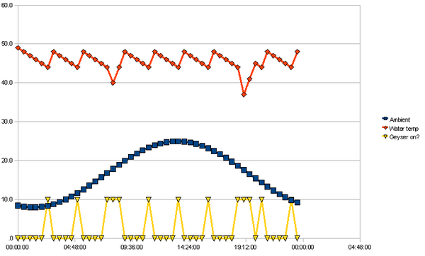

I don't have a data logger (any contributions accepted :) ), but I do have a spreadsheet. So I started with a simulation. Parameters are:
Time step 00:30:00
Max ambient 25
Min ambient 8
Min deg (geyser) 45
Max deg 50
Loss deg/hour 2
Heating rate deg/hour 10
I am trying to keep it simple as possible, e.g. for cooling due to water usage, I just enter the degrees by which the water is cooled within each time slice.
Can you help with a highly simplified formula, which gives degrees lost as a function of (only) geyser temp, ambient temp? Each cell will have the formula:
Temp = previous temp + heating deg/hour (if geyser on) - degrees heat loss (fn of ambient temp) - usage degrees lost
Here is the graph so far - seems to be kind of sensible!

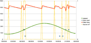

Instead I did something useful...
Graph draft 2
I put some guess figures in, like 35 litres hot water used in the morning and 40 in the evening.
Looks realistic to me so far! :thumbup:
Could still add some things, like T[n+1] = T[n] - (T[n] - T[ambient]) x fac maybe?
One surprising result so far in the model is that the bigger the geyser capacity, the less the electricity used! Do you think that's accurate?

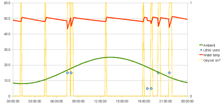

Below are the parameters so far. Can you check and suggest improvement? I have chosen thermostat hysteresis as 2 degrees - complete guess. The ambient temperature varies as a sine curve peaking around 1pm. As before, 70 litres hot water have been used.
Guestimated values
The total daily power use comes in at 4.8kW - seems too low. :problem: I would expect 10 - 15 kWh.

windgat wrote:The total daily power use comes in at 4.8kW - seems too low. I would expect 10 - 15 kWh.
4.8 kW looks OK to me. :?:

Postby windgat on Sun May 31, 2009 4:10 pm
'Normal' suburban household use ~30kWh a day; 'normal' percentage of total bill due to geyser ~40-50%, hence I thought 5kWh too low...
Ok, so here is the graph. Whad'ya think?
Draft 3

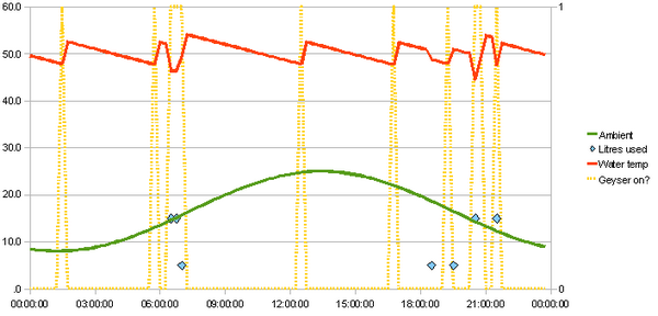

Postby windgat on Sun May 31, 2009 9:39 pm
Similar to :?:
Here is the spreadsheet, see if its usable/improvable?
To get a smooth temperature at midnight I manually fiddle the starting temp to about match the ending temp. It may need to be over multiple days for more accuracy.
Geysergraph.xls
Geyser power usage model
(180.5 KB) Downloaded 11308 times

Postby Greystoke on Mon Jun 01, 2009 7:19 am
windgat wrote: . . To get a smooth temperature at midnight I manually fiddle the starting temp to about match the ending temp. It may need to be over multiple days for more accuracy.
Did the same thing trying to get an estimate for the thermal resistance of my geyser. I'm sure its the right order of magnitude, but I truly haven't a clue how accurate it is.
I have a spare kWh meter in the granny flat. It's a bit of a mission to install it in-line with the geyser, but if I DO want to make savings, I need accurate data.
Perhaps we're a bit impatient. Let's go back to school, ie: Fit the theory, then check validity with measurements.
BTW: I'll check the spreadsheet today.

Postby Greystoke on Mon Jun 01, 2009 9:11 am
Nothing wrong here. :!:
In fact, if I enter my conditions (as above) I get a use of 4.67 kWh as opposed to 4.62 kWh in my calculations. That's ±1% difference. Not bad what :?:
There's a bit of aproblem getting the timing right. Meaning: when to switch on and when to switch off. It doesn't seem to happen exactly at Tmin and Tmax, but it does come right (more or less) on average. (my heatloss= 100 Watt, yours= 97.2 Watt)
I think the time has come to validate our constants, ie: kWhrs, thermal resistance.
