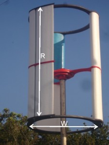

How's this design :?: The center hub floats on a magnet, and the coils that generate the power are at the outer ring, with magnets at the tips of the blades flying over them at high speed. It's about 1.2m high by 0.6m wide . . . . Sexy :!:
Regards
Cor
Greystoke
Hyper active member
Posts: 180
Joined: Thu Jun 05, 2008 9:10 am
Location: Port Elizabeth, South Africa
Re: Vertical Axis Wind Turbine (VAWT)
Postby windgat on Mon Jun 29, 2009 5:39 pm
It would great if you could find some figures and how close to the Betz limit such a design can get.
It looks like a cone, so the area would be about 1/4 of a square metre? That doesn't seem like much power could be generated. I guess you would be very lucky to get 50W in a 10m/s wind.

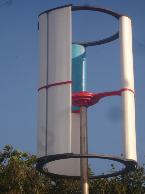

Good Day all. On Saterday 15/8 I managed to finally assemble my vertical unit for testing. The unit has no geni in yet. At the time off this pic the wind was not strong enough to move the leaves on the tree next to me but the unit was turning with ease. Tried to place 5sec video clip. The geni is ready but want to test the blade desigh before ant major installs.

Postby windgat on Mon Aug 17, 2009 11:11 am
Looks great so far. Crucial issue is of course not how fast it turns without load, but how much torque it can push into the geni.
Postby basiedp on Mon Aug 17, 2009 4:43 pm
I agree, if the design works maybe will have to enlarge blade size to get over gogging effect or get down to paper and look at another layout off coil to magnet. Currently I have no idea what torque value's are.

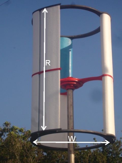

Output power of a VAWT versus a HAWT
Wind power output = 0.5 x ? x A x v³ x f
In which:
? = air density [kg/ m³]
A = swept area [m²]
v = wind speed [m/s]
f = conversion factor (eg:Betz limit x efficiency)
fmax (horizontal hi-speed turbine) = 0.46
fmax (VAWT: Darrieus )= 0.42
A (horizontal turbine)= ? x R²
In which R = blade length [m]
A (VAWT)= R x W
In which W = width of the swing [m]
Ratio VAWT/HAWT = (W x 0.42)/( ? x R x 0.46) = W/(3.44 x R) = 0.29 x W/R
So,
If you can make a VAWT which is 1.72 times (half of 3.44) wider than the full swing of a HAWT, you should be able to get more power out.
Comments :?:

Postby windgat on Wed Aug 19, 2009 4:20 pm
...wider... than 'full swing'.... :wtf: I am lost.
Postby Greystoke on Thu Aug 20, 2009 5:26 am
The airflow through a VAWT has an area defined by: square with height = R, width = W.
The airflow through a HAWT has an area defined by: circle with diameter = 2R (="full swing")
:thumbup: :?:

Postby windgat on Thu Aug 20, 2009 5:30 pm
Ok... so Ithink what you are saying is that fmax is 0.42 for Darrieus, and 0.46 for HAWTs.
So a Darrieus needs to be about 10% bigger in area to get the same power?
