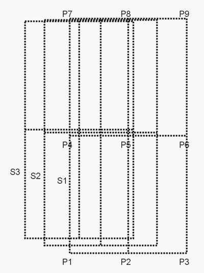

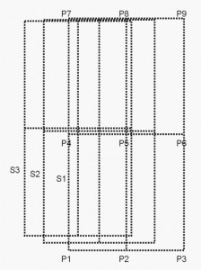

Re: Magnet strength
Postby windgat on Sun Jul 13, 2008 10:17 pm
Diagram for magnetic force spreadsheet calcs from Greystoke
magnetic force.zip
Magnet force spreadsheet from Greystoke
(214.88 KB) Downloaded 4091 times
Re: Magnet strength
Postby Greystoke on Mon Jul 14, 2008 6:42 am
Hi windgat,
Thanks for uploading that file. Still don't know what my problem is. I'm still working on some more explanatory notes. When I'm ready with that I'd appreciate if you updated the new file.
