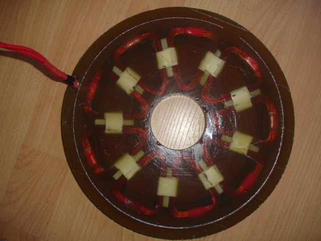

Postby basiedp on Sun Aug 16, 2009 9:56 am
Hi all. Just to show what is going on in PE. These coils were wound on a homemade winder. The material for casting was gps resin, cheap. If all the tests comes out to the correct figures the coils will be casted in apoxy resin that's much more in cost.
The magnets used for this unit, 24 off wedge magnets. :thumbup:
basiedp
Contributor
Posts: 12
Joined: Wed Aug 05, 2009 6:36 pm
Location: Port Elizabeth
Re: Stator material
Postby windgat on Mon Aug 17, 2009 11:07 am
Looks good!
Re: Stator material
Postby bacharoo on Fri Jul 16, 2010 2:48 pm
Hi Basiedp,
I really like the finish of your stator. What did you use for you outer ring that contains the coils and epoxy?
