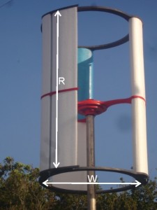

I have gone with a Savonius design I found online. It is based on the following basic design
This is supposed to be more efficient than a regular drag design for 2 reasons. Firstly, the wind coming in the one side is channeled through the center to the other side and expelled, creating some extra force on the opposite end. Secondly, the curved surfaces act like an aerofoil and are supposed to create some lift, which also helps spin the rotor. If these 2 parameters actually make any difference, I don't know, but I liked the design anyways. Here is a pic of my turbine from the top.
