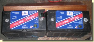

Postby windgat on Tue Nov 18, 2008 9:22 am
They seem good so far. They are 'high cycle' sealed batteries, which is a sort of made up term. Just means the plates are a bit thicker than usual. They are rated at 102 ahmp hours, load test 310 amps. I treat them very carefully - I never let them get below 12.2V.
Lead acid batteries can get sulphated beyond repair, which happens when they are left uncharged for a while. If you test the battery with a voltmeter and its less than 11.5V or chances are its not good. But for R50 you can't go too far wrong. If its less than 10V that probably means one or more cells are dead. Some places have fancy chargers which can desulphate to a degree, so if you buy one try and take it to a battery specialist immediately for some tender care.

Postby ibo solucoes on Tue Nov 18, 2008 2:10 pm
Talking about batteries... What about UPS type batteries, they are sealed and have fabric in between the plates holding the acid... they are cheaper (new) to buy then deep charge batteries, does anybody have experience with these? They are designed for slow discharge...? Can they survive repetitive discharges? How do they compare with the more classical lead acid (deep cycle) battery? These deltecs are still designed to be able to withstand knocks (automotive, boat use) etc... so i guess you pay a premium for that? Anybody know a website comparing all these?

Postby windgat on Tue Nov 18, 2008 2:29 pm
UPS batteries are designed for very infrequent use (most of the time they are on float charge). I think these are usually standard sealed lead acids (SLAs).
As far as I know if you always keep your batteries at or above 12.2V you will get very long life out of them. Leaving them discharged for long periods is what causes sulphation of the plates, which is hard or impossible to remove by charging.
