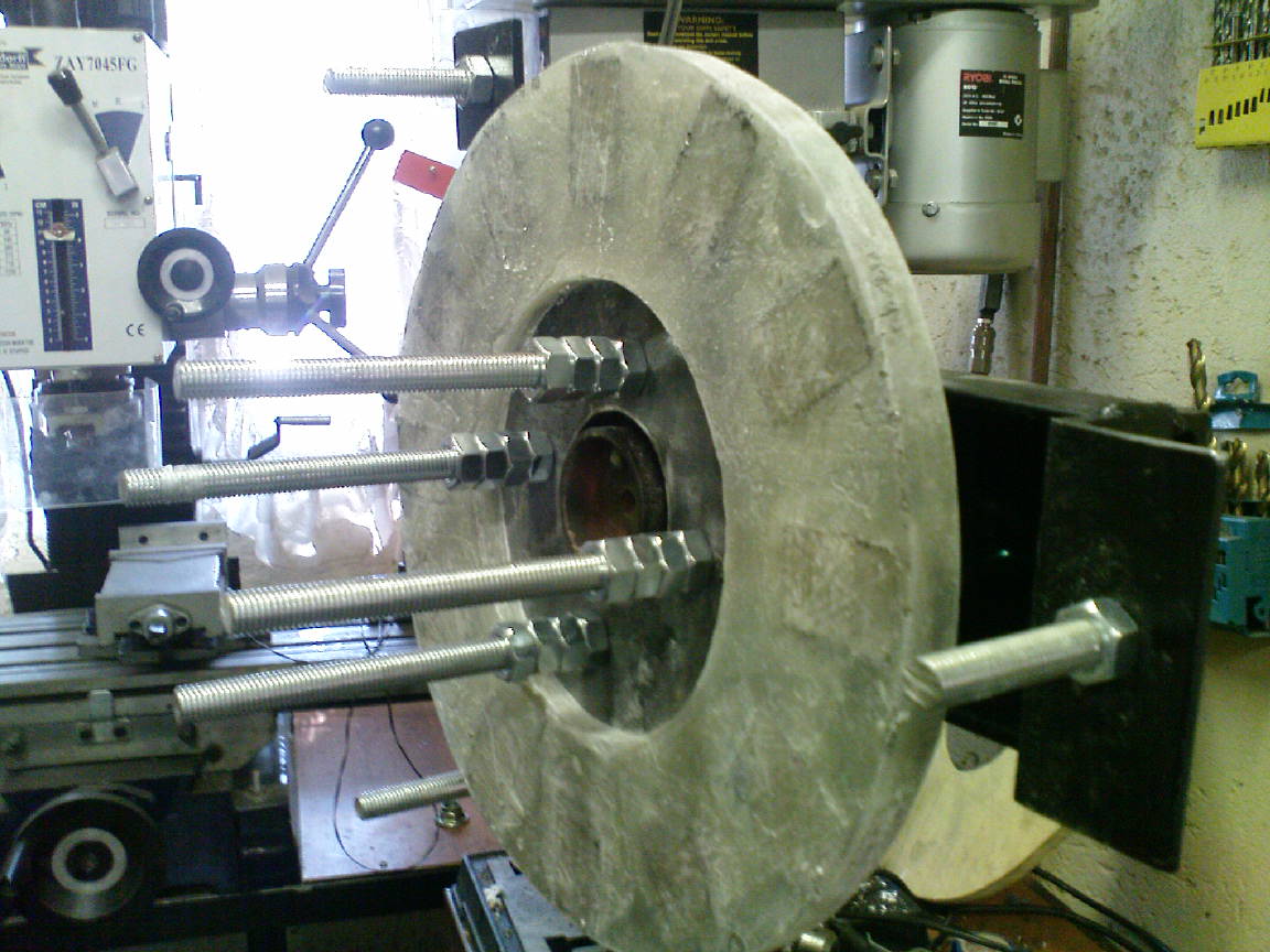

Day 9 - Finally got some time to assemble the altenator
Back rotor and 12mm studs
From the side

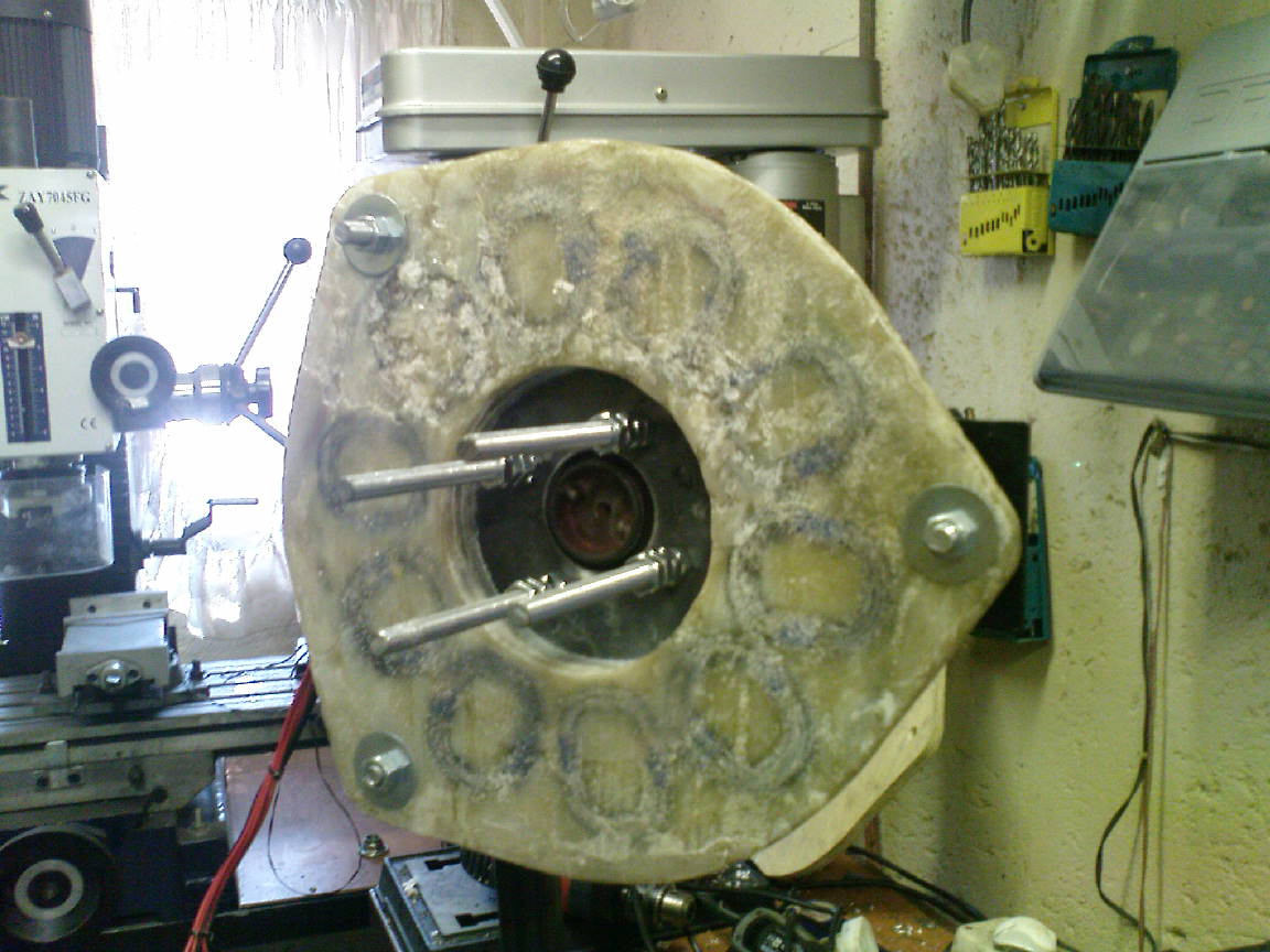

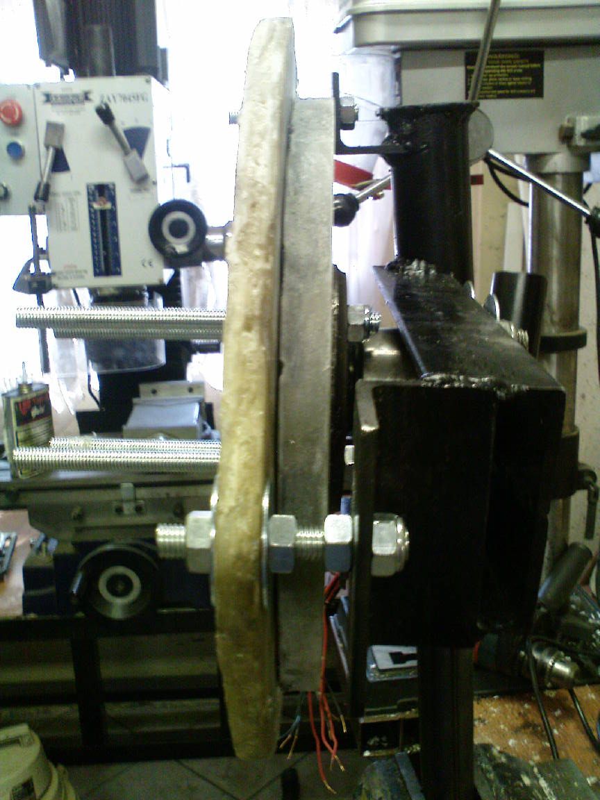

Stator and back rotor assembled
Stator and back rotor from the side, not much of a gap between the two

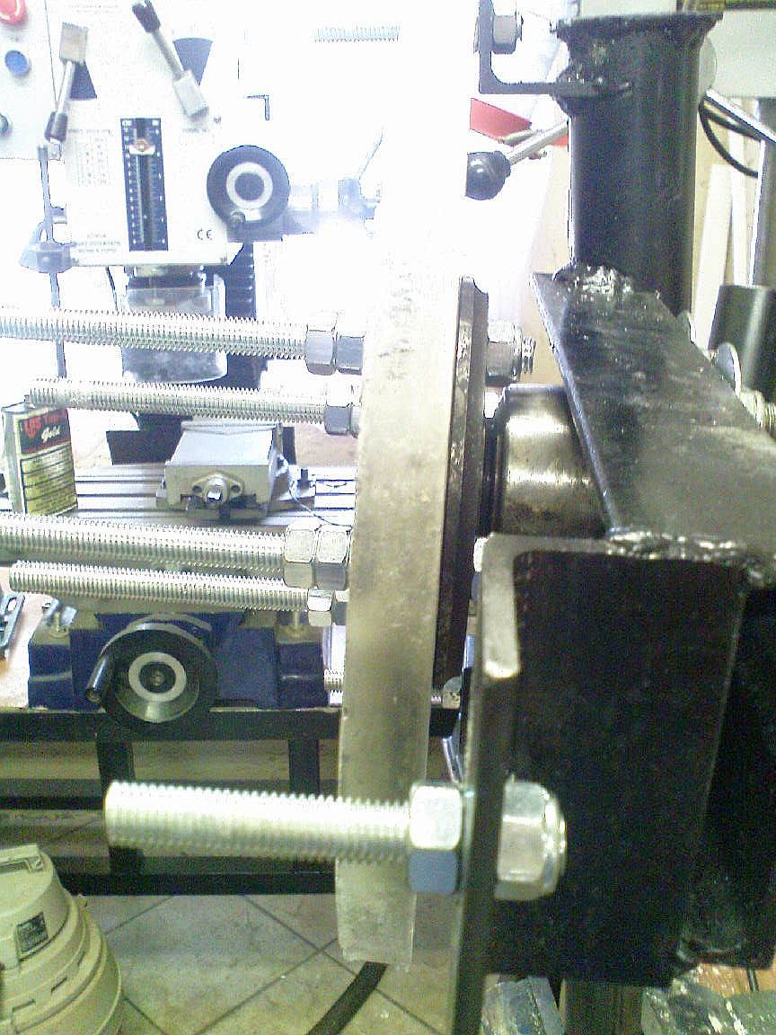

Front rotor with jacking screws, ready to go onto the studs, this is the dangerous part :shock:

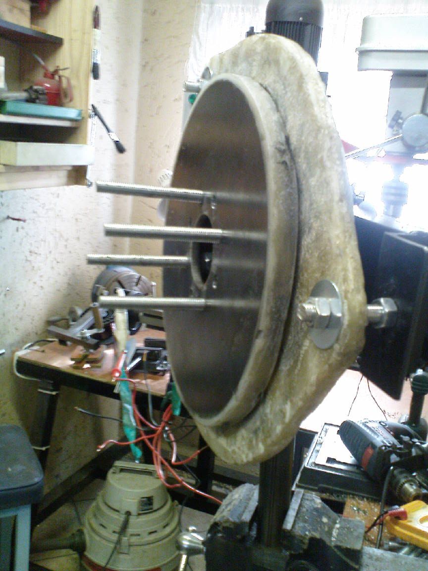

8) Phew-- front rotor is on and I still have all my fingers 8)
Its amazing how much force there is between the 2 rotors, the front rotor crashed down on the jacking screws with a bang...

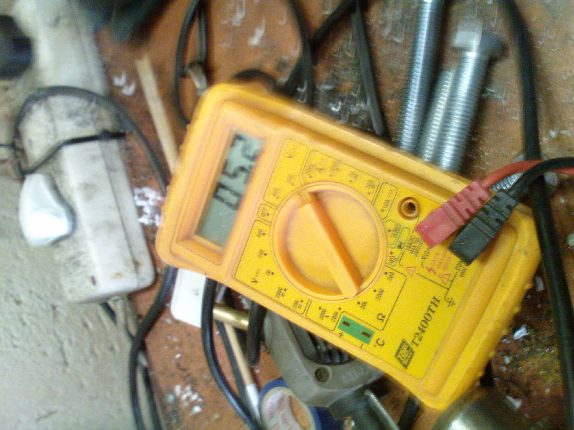

After adjusting the rotor spacing (I had to add another nut to each of the studs), I have about 4 mm between the front rotor and stator and 4mm between the stator and back rotor, I think what I'll do, is to replace one of the nuts on each of the studs with a washer or two. I dont know is the airgap is toooo big, but it seems to be fine, making between 2,5 and 3,5V at ~60 rpm, one rev per second or as close as I can get it
MAKING WOOOOOPPPPEEEEE!!!!
Thats all for now, next step is to disassemble it again, do some spraying etc , reassemble and try and get the airgap as small as possible..

I would like to know, when you lift the rotor with the jacking screws, how many turns do you make on each screw? I use 3 bolts (you have 4) and I found that at first half a turn was the max I could do without the rotor tilting.

windgat wrote:I would like to know, when you lift the rotor with the jacking screws, how many turns do you make on each screw? I use 3 bolts (you have 4) and I found that at first half a turn was the max I could do without the rotor tilting.
mmh not sure what you mean, I do all 4 screws, 2 or 3 turns on the bolts at a time, then, when I can get 2 pieces of wood between the rotor and stator, I lever the rotor off as far as I can and then lift it off the studs

Sort off, connected the red lead on the meter to one coil tail, choose another tail and connected the black lead to that tail, did some spinning, checked the voltage, then connect the black lead to another tail, etc.. Problem is, I do not know which tail goes to which winding, what I did is, I connected all end tails of windings on the left side with red wire and the right hand side with black wire, so I have 5 x red and 5 x black, but I do not know which is which. All the start tails of all the windings are connected in a ring, but there is no outside connection.

That is what I meant, thanks. When I tried 2 or three turns I found the rotor would tilt, and jam. Maybe that's because of using three jacking bolts instead of four.
About testing the coils: that's ok, you have one 'common' connection and 5 independent connections. To test all the phases are good you would connect one voltmeter lead (in AC volt mode) to the common connection, and the other lead to each of the 5 independent ones in turn. You should get the same voltage from each at the same RPM.
