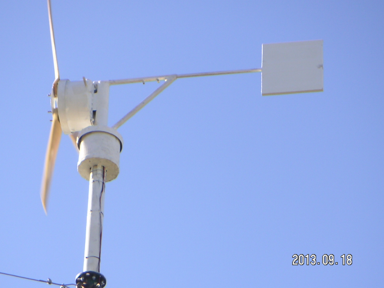

Postby turning green on Sat Sep 21, 2013 1:08 pm
I've been away for quite a while. The main reason, I suppose, was that I had a heart attack in 2009 and again in 2010. That shouldn't have kept we away from this site but my first turbine also got blown out of the sky. I sort of gave up on wind energy. My solar geyser and PV panels have been eminently successful.
I hate failure and I hate to give up.
The broken turbine lying in my garage was an offense to my ego. I lasted two years and then gave in - started again.
This time round I was not going to let the wind win. There is a sort of goal for this site to keep things simple to the point that most things must be able to be done in a DIY manner. I honored that only in that I put the lot together in my garage and my backyard mostly by myself. Where I deemed it necessary to go expensive or hi-tech I went. This was going to be my swansong anyway.
The big picture required that I make the mast more stable and then make the actual turbine more robust.
The top end of the mast was a 60 mm dia steel pipe - that was replaced with a 100 mm dia steel pipe. I erected stays E, W, N and S for the two main mast supports and then four more stays to the top of the mast. It was all fairly lo-tech but it did require some poles to be planted and proper telephone pole staywires to be bought and installed. I got fairly good stuff at a metal salvage yard.
The turbine. The non-rotating tower (n-r-tower) is 100mm dia steel pipe (same steel as the top of the mast). The rotating tower (r-tower) is 80mm dia steel pipe (just fitted inside the 100mm pipe). The T-Pce base of the turbine is made of 70mmx35mm channel. The central shaft of the turbine is 30mm bright steel. I had the steel plates with the magnets machined for suitable 30mm bearings. The hub plates for the blades are 8mm steel plates. Between the n-r-tower and the r-tower is a 80mm ID thrust bearing (expensive and hi-tech). Above the thrust bearing is a 80mm electrical swivel and pick up (from an electrical motor - expensive and hi-tech). In fact, all that remains of the original turbine is the two steel plates with their magnets and the stator. I made suitable covers out of galvanised sheeting.
I've directed the total electrical output to my geyser element. I broke the thermostat to prevent any possible open circuit to protect the turbine and isolated the geyser totally from the mains. ie. No batteries - no control circuit. I might change my mind later.
We've had some fantastic winds and the turbine has shrugged them off.
I claim success !!!!
