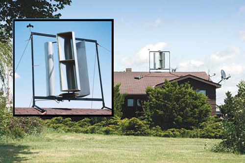

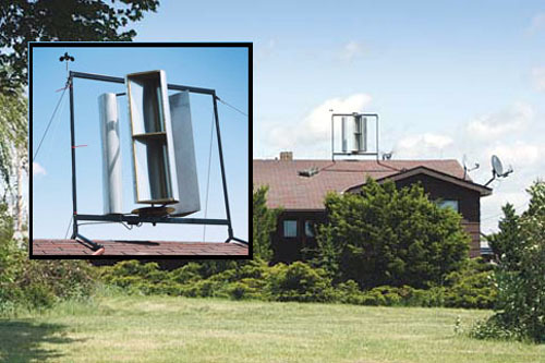

Ok I'm thinking ahead of time here but maybe I should build a vertical axis wind mill and I say this for two reasons the area were I stay and also any wind direction will spin it.
My idea is 1.5M heigh and radius a 27inch bicycle wheel with 110mm drain pipe as the veins.
Just a though for now, any suggestions.

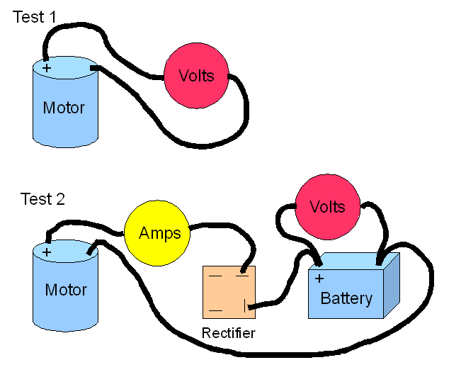

What I meant was:
Test 1 (open circuit):
Connect a voltmeter across the motor
Measure voltage and rpm across a range of rpm, at least up to where you get 14V or so.
Test 2 (battery as load):
Connect the motor to the (flat) battery, with an ampmeter in series with one of the leads
I.e. motor negative to battery negative; motor positive to ampmeter connection 1, ampmeter connection 2 to battery positive
Connect a voltmeter across the battery (or the motor, should get same result)
i.e. voltmeter negative to battery negative, voltmeter positive to battery positive
Measure voltage, amps and rpm across a range of rpm.
For test 2, you should get 0 amps at low rpm, then at some point (cut in speed) you will start to get amps. For this test, all the voltages should be close to 11.65V (or whatever volts the battery is at).
Finally, plot V against RPM from test one, and then seperately plot V x A (ie watts) against rpm for test 2.

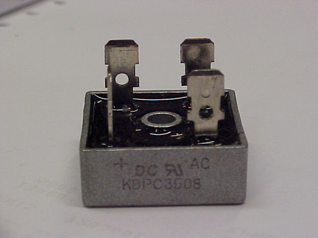

If you get a bridge rectifier that can handle 30 amps that will be plenty. Should be around R30 or less. Get two, then you can use them if you make your own alternator (AC generator) one day.

Ok, here is a diagram I made for you. Please let me know any questions.

My plan is to build a vertical axis turbine but mount it on the top of a pole and not my roof.
This is because of my position and think that an all direction wind turbine should work best.
If the DC motor is no good them I'm going to try to build one of your generators with magnets and all.
This model according to the plans is 3ft diameter and 4ft tall.

Sounds good, look forward to hearing more. Remember that a horizontal axis turbine is also an 'all direction' turbine, in that it rotates according to the wind direction. The vertical access design is less affected by constantly changing wind direction, but is less efficient in a constant wind due to the fact that the blades are moving into the wind about half the time.

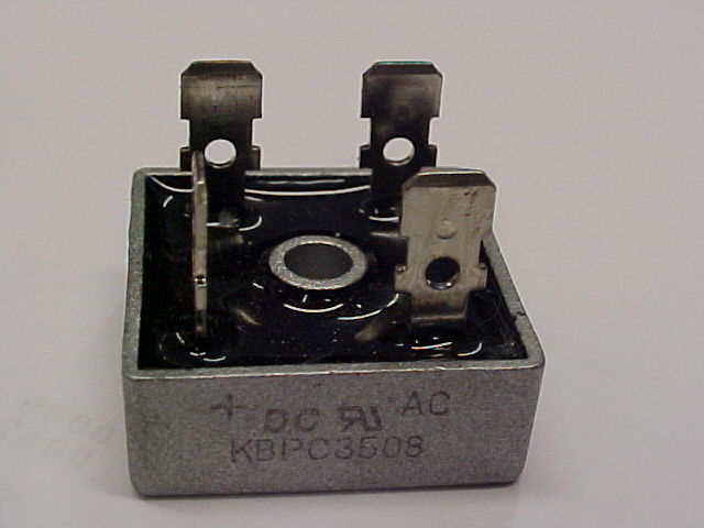

Ok Test One went off well but test two I dont know but I followed your diagram but once I connected the bridge Rec I got nothing out of the motor.Maybe I'm doing something wrong here.

One of the tabs is different to the other three - that's the positive one. Try leaving the battery out at first to check you have everything correct. Then you should see some voltage when turning the motor. With the battery connected you will only get something when the RPM is high enough to generate more voltage than the battery.

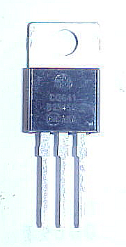

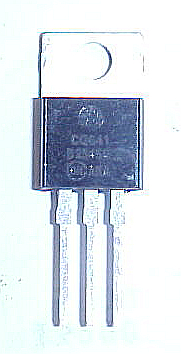

Did some research on the net last night and they say to use a Schott Diode in line so that the battery does not try to run the motor BUT they don't show how to connect.
Do you have an idea how to connect it.
It is a Schottky Diode 25A-45v Diode.

You can use this, but it is almost exactly the same effect as the bridge rectifier which I showed in the diagram above how to connect. As I recall the two outside pins (or just one of them for testing) go to the positive of the motor, and the centre pin to the positive of the battery. If you get it the wrong way around, the motor will spin (or try and spin if the voltage is too low).
Disadvantage of the Shottky is that you would need a heatsink in practice. I suggest just go with the bridge rectifier as initially planned. The voltage drop is slightly more but (if you look at the 'Electronics' page) I found it to be insignificant.
