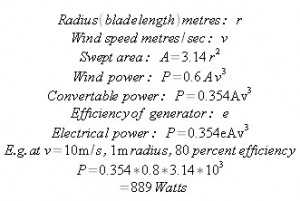

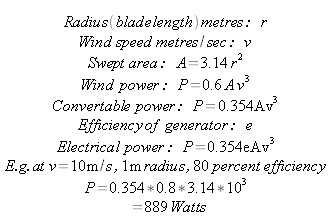

Postby windgat on Mon Jul 21, 2008 10:01 pm
Here is a formula to work out the power produced by a wind turbine.
E.g. at v = 10m/s, 1m radius, 80 percent efficiency
P = 0.354 * 0.8 * 3.14 * 10*10*10 = 889 Watts
(This formula can be used to prove certain marketing claims to be patently false.)
Wind turbine theoretical power
