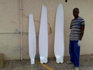

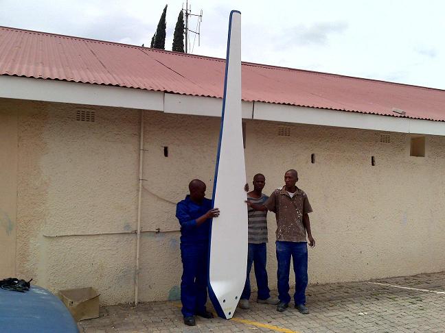

Our company manufactures glassfiber windturbine blades
for 1kw to 10kw windturbines.
One of our customers is: www.winglette.com
We are interested to sell our blades via this website.
kind regards, Nico van Meurs 083 257 4241
Some pictures attached.

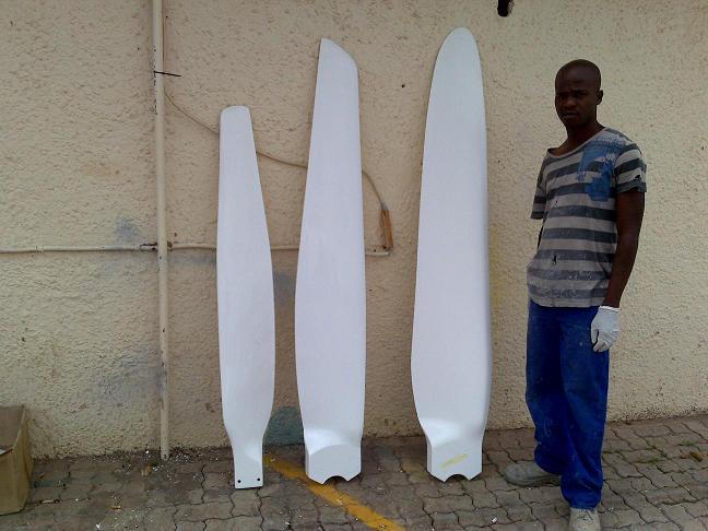

We currently only manufacture the blades shown in the
pictures. We can design and manufacture a customer
specific blade but that would be a fairly expensive
exercise. The 1.5m blade (shown in picture) is our
smallest blade. We have no intention to design or
manufacture any smaller blades.

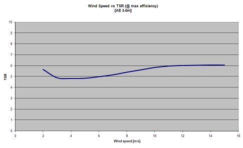

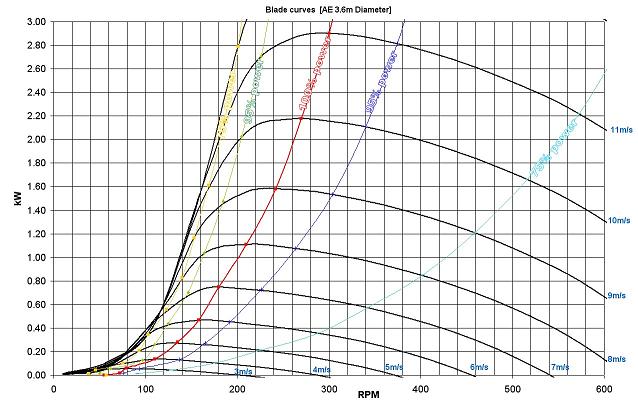

Can you mention the specs of your blades, e.g. rpm vs wind speed, TSR etc? Also, do you have a drawing of the spacing of root mounting holes?
1.8m blade specs
Postby aero energy on Thu Apr 30, 2009 10:40 am
For our 1.8m blade (3.6m diameter):
aero energy

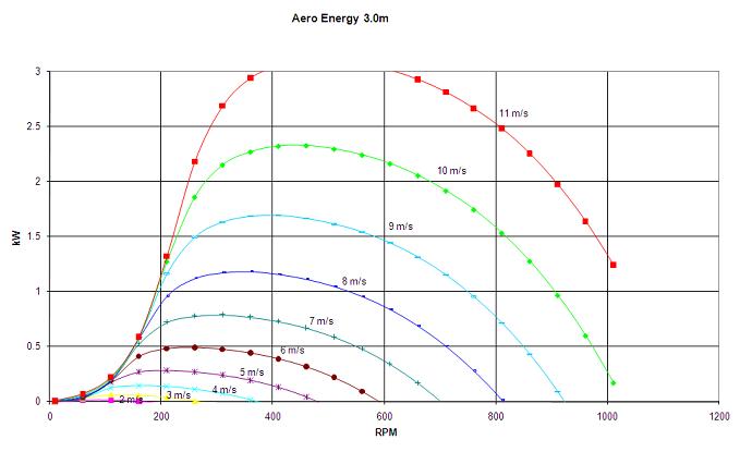

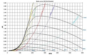

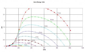

1.5m blade specs
Postby aero energy on Thu Apr 30, 2009 10:55 am
Only power curves.

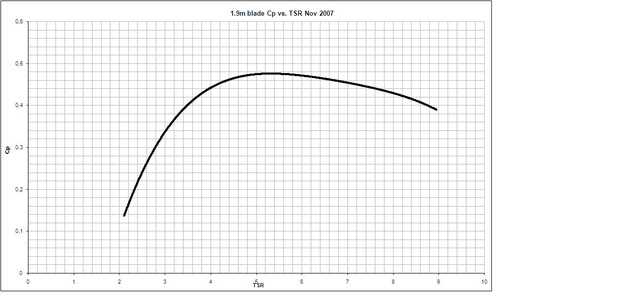

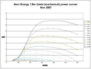

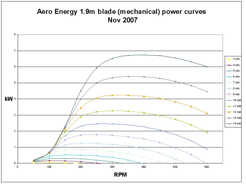

1.9m blade specs
Postby aero energy on Thu Apr 30, 2009 11:06 am
Holes identical to 1.8m blade.

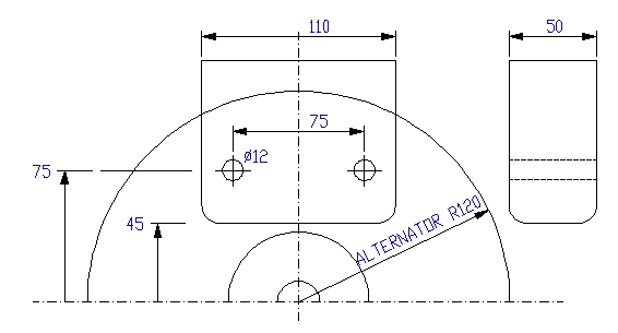

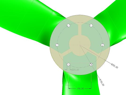

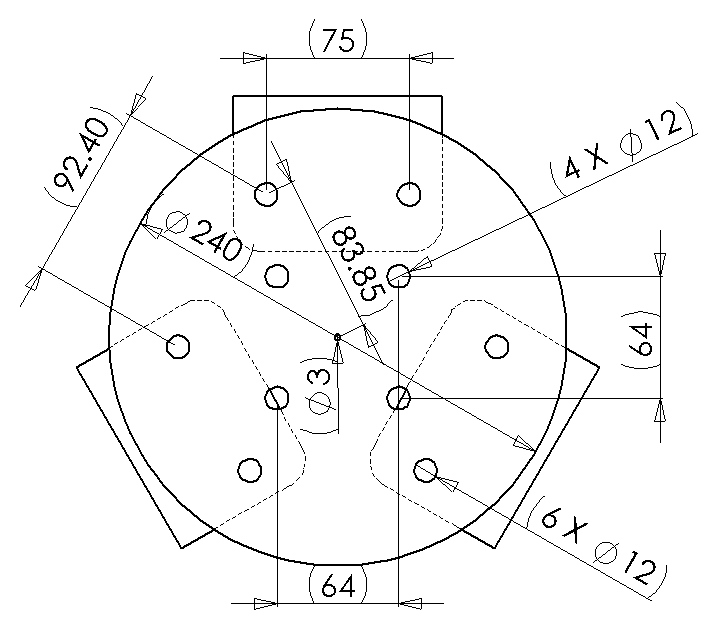

Could you please post a diagram of your mounting holes for the 1.5m blades?
Re: Glass fiber blades
Postby windgat on Tue Jun 16, 2009 9:57 am

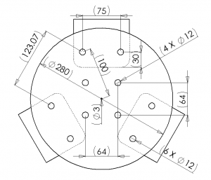

Would this be right?
And what material and thickness would you recommend for the hub?
Postby aero energy on Thu Jun 18, 2009 9:37 am
The mounting would need to look more like this.
I am aware of people using a 8mm thick steel plate.
That sounds pretty solid to me :)
aero energy
Active member
Posts: 22
Joined: Tue Apr 28, 2009 11:04 am
Postby windgat on Thu Jun 18, 2009 11:05 am
Ok, I changed it based on that diagram. A catch I must work out is that the blades would overlap the hub mounting bolts, as shown.
Steel plate sounds heavy! I have used GRP reinforced 12mm marine plywood to date. What is your view on that?

Postby aero energy on Thu Jun 18, 2009 2:14 pm
1. The holes
Unfortunaly we can not easily shift our holes easily. We are
using a drilling-jig for that and moving the holes would
require some modifications to that jig. Its not impossible
but it would probably take us a few months.
The part of the blade interfering with your bolts is
completely solid (wood) and one solution is obviously just to
create a small gap in the blade with a drill. There will
be little consequences from a strength point of view.
You might just have to protect the wood with some
resin or decent paint.
2. Hub plate
We are a bit new to the home-built market.
Our regular customers like to overdo things
because things keep breaking if they are too
weak. 12mm re-inforced plywood sounds
solid to me but we have no experience with it.
Try asking Hugh Piggott or maybe Paul Marais?

Postby windgat on Thu Jun 18, 2009 2:28 pm
How about if I mounted the blades an extra 20mm out from the centre? Would that throw out the blade aerodynamics?
Otherwise carving a bit off the root as you say shouldn't be hard.
For the hub, perhaps I'll put a second plywood disk on, i.e. making a sandwich (with ply as the bread and the blades roots as the peanut butter).
Postby aero energy on Thu Jun 18, 2009 3:38 pm
Blade aerodynamics would not be affected.
In fact you performance might just get a bit better due to increased diameter.
You just need to make sure there is enough material clamping the blade.
About the plate. I was already assuming you were using 2 plates :)

Postby aero energy on Thu Jun 18, 2009 5:11 pm
I just had a good look at our drilling jig.
We can shift our holes about 10mm towards the root.
Would that be enough?
Postby windgat on Thu Jun 18, 2009 5:44 pm
I'd say keeping it standard is best, to avoid possible confusion in the future. I will make a hub to match your holes.
Postby windgat on Thu Jun 18, 2009 11:19 pm

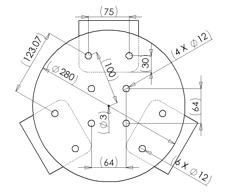

Ok, here is an updated drawing of the planned hub, for your (hopefully) approval.
Now I just have to work out how to make these holes accurately in the ply!
Is there a process you recommend for aligning the blades accurately before tightening the bolts? Presumably there is a little play with just two holes...
Tip distance
Postby aero energy on Fri Jun 19, 2009 11:43 pm
That drawing looks excellent to me.
Just wait until next week before cutting it :)
You brought up a good point with regard to alignment of the blades.
Its absolutely critical that the angles are 60 degrees.
Just before tightening the bolts you would need to measure
the distance between the bladetips and make sure they are all equal.
Anything less than 2mm is acceptable. Anything more will
vibrate your tower to pieces.

Postby windgat on Sat Jun 20, 2009 12:03 pm
Hi Aero. I am trying to plan a generator to match your 1.5m blades, so I need the power curves. I see under "1.5m blades" above you posted a graph, but the graph is title "1.9m". Do you have anything for the 1.5's? I understand its a whole process to measure, but do you have at least the theoretical curves? If I test your blades on a generator that is badly mismatched to the blade power curves, the results will not look as good as they should.
1.5m curves
Postby aero energy on Sun Jun 21, 2009 4:49 pm
I am confused by your post. Under "1.5m blades" I see only one graph
containing the 1.5m blade curves. The graph name is "AE 3.0m.jpg".
The graph title is "Aero Energy 3.0m". What am i missing?
aero energy
Active member
Posts: 22
Postby windgat on Sun Jun 21, 2009 5:32 pm
Aha, it is me who was confused! I thought that was 3m radius, but I get it now.
I have tried to read values off that graph but its a little inaccurate. Could I see the source data? What I am after is the maximum points of each curve, which I would then use to select an appropriate generator configuration for your blades.
