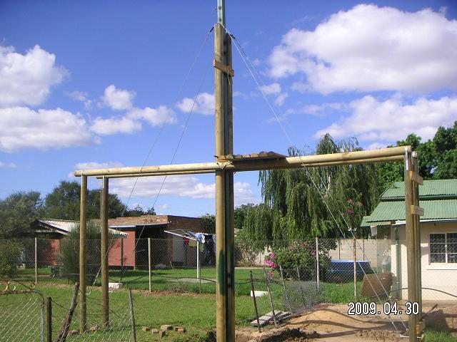

Re: My Huge Heavy Mast is Up
Postby turning green on Wed May 06, 2009 4:52 am
Picture of the mast. The extension pole has not been added yet.

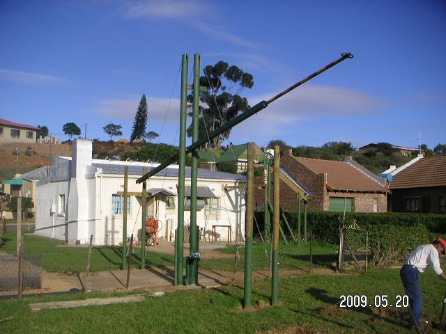

Postby turning green on Tue May 19, 2009 8:04 pm
My Huge Heavy mast takes a bow.

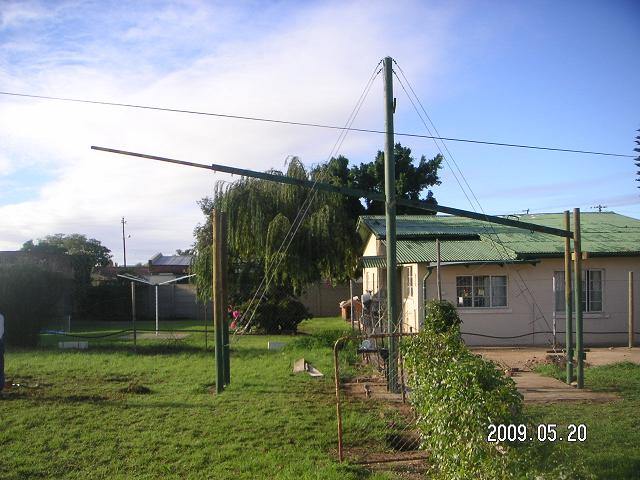

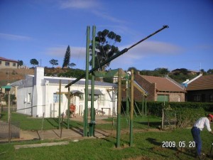

Postby turning green on Tue May 19, 2009 8:10 pm
Side View of the mast bending down - ready for the turbine.

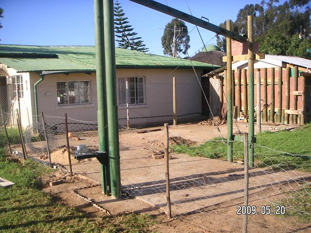

Postby turning green on Tue May 19, 2009 8:14 pm
Boat Winch in Action.

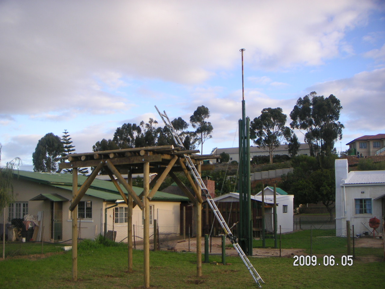

Postby turning green on Sun Jun 07, 2009 2:28 am
Well I'm on my way to Texas where there are some big wind farms and my son has promised me a tour of one !!! I'll post a pic or two if it materialises but mainly I'll share with you my impressions. I know I'll fly over hundreds of turbines with him in his Cessna Cardinal. There is a good chance that I'll be given a look-in at the engineering section at Boone University in Boone, North Carolina, involved with green technology. I'm going to try to see their Biology section involved with sustainable agriculture as well if at all possible. Should be interesting to see what can be done with youthful zest and intelligence with adequate financing ???!!! My efforts at going green will probably look embarrassingly primitive. If it's at all possible I want to see a Concentrating Solar power station (you know, with all the mirrors) and maybe even a photovoltaic one in California where my other children live. You've probably realised where my interests lie at this time.
To return to my mast. I've built the access platform and I've put on the final 2 meter stainless steel extension to take the turbine, which incidentally I already have. It's all got to wait now.
My huge heavy mast now stands at it's full majestic 9.5 meters. Unfortunately the final 2 meter stainless steel extension is not shown in the picture as I took the pic immediately after completing the access platform.
