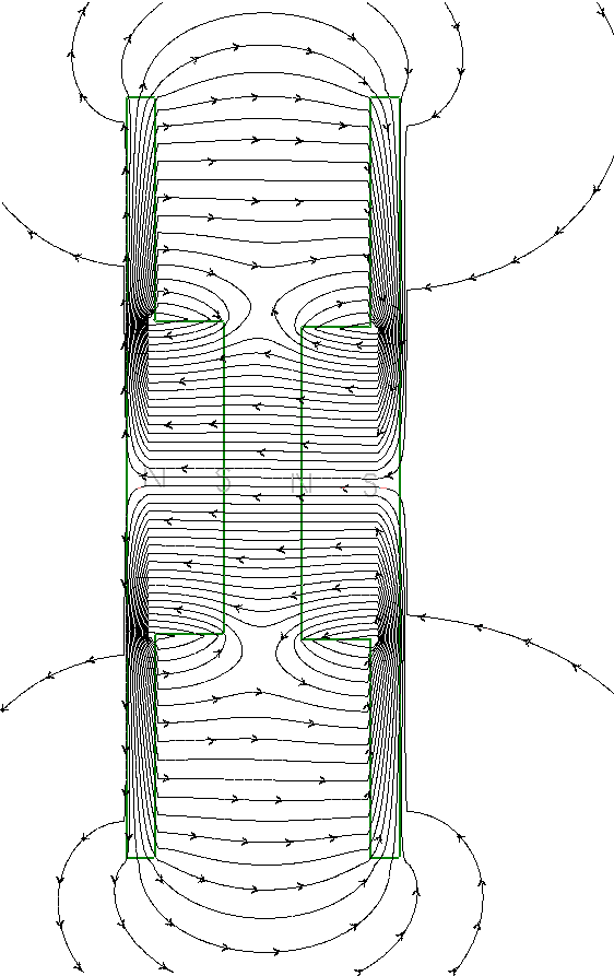

BTW, I created this image with Vizimag, which shows fairly accurately the field between two magnets as they are in the generators.

That's a powerfull program you got there. It gives a very good idea of the field distribution, and this picture supports the suggestion that the coils should never be much bigger than the magnet.
