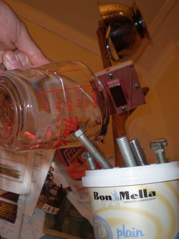

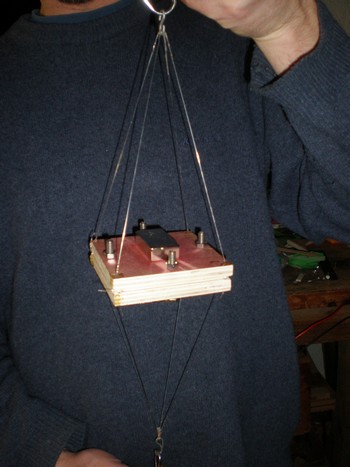

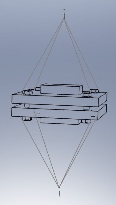

Good day to the boffins here,Here is my idea on how to compare magnetic strength between different magnets.
Using a strain gauge as is used in an electronic scale,but one that is used for pulling power,connecting a metal plate to it.
And putting a magnet onto the metal plate then putting a second plate onto the other side of the magnet. a bolt with a fine
thread is fitted to the second plate going through a jig with a nut,as the nut is tightened a reading of mass will increase until
the magnet come loose, at least then it will show which magnets are stronger and/or weaker.
You guys are boggling my mind with your formulas.
